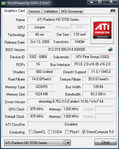

gpu-z : http://gpuz.techpowerup.com/10/10/30/20v.png
