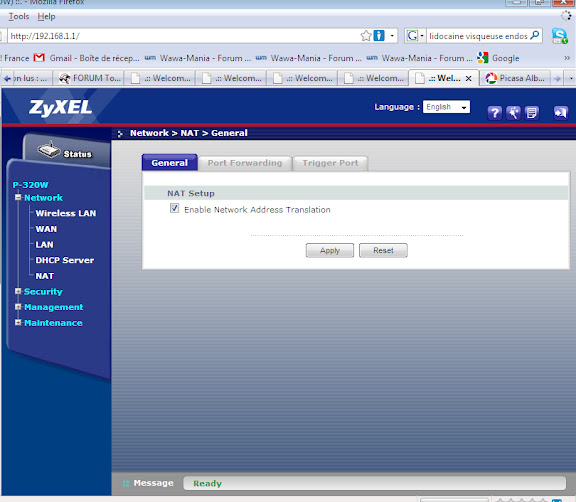

Voici les différents écran pour configurer le 320.
C'est ici que ca bloque, je pense que c'est au niveau des passerelles DNS ?, ou de l'IP lan ?
http://lh3.ggpht.com/_K2l6jWgozfY/TBnpuNzR-QI/AAAAAAAAE...
http://lh5.ggpht.com/_K2l6jWgozfY/TBnpuv0N9DI/AAAAAAAAE...
http://lh5.ggpht.com/_K2l6jWgozfY/TBnpu0psXeI/AAAAAAAAE...
http://lh4.ggpht.com/_K2l6jWgozfY/TBnpvFPy2MI/AAAAAAAAE...
http://lh5.ggpht.com/_K2l6jWgozfY/TBnpveu6b7I/AAAAAAAAE...

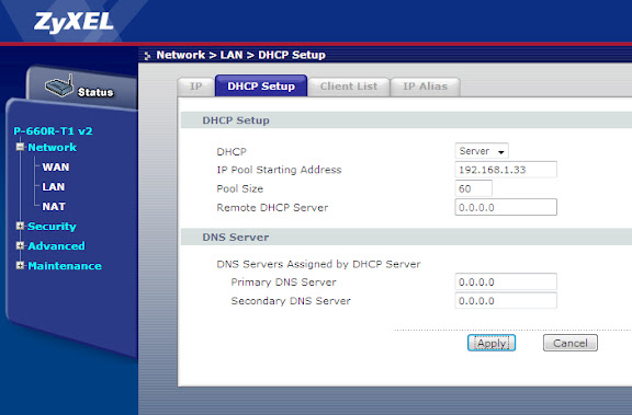

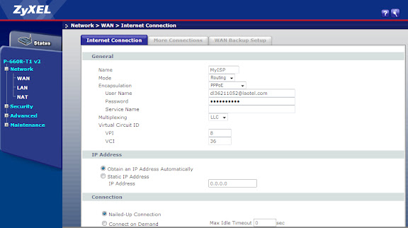

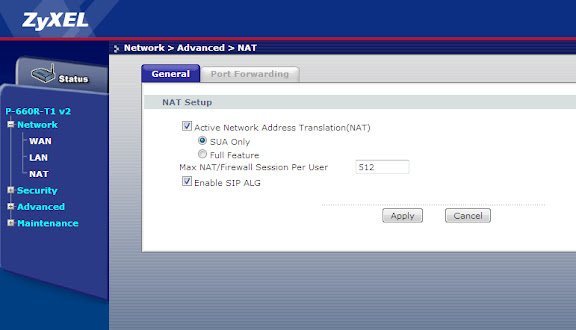

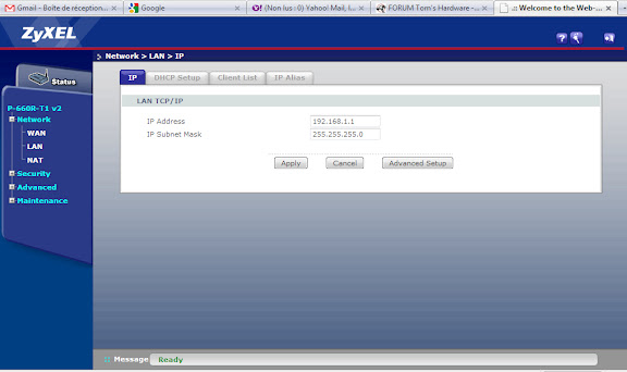

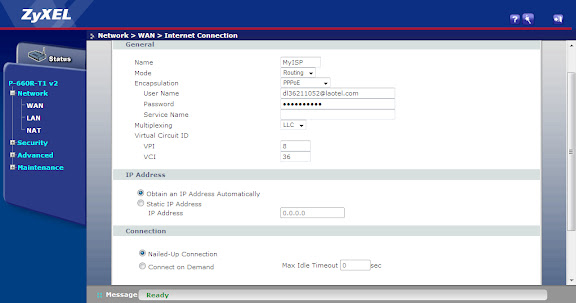

Voici maintenant l'interface du 660 (celui qui fait modem ) :
http://lh6.ggpht.com/_K2l6jWgozfY/TBrvnT525RI/AAAAAAAAE...
http://lh6.ggpht.com/_K2l6jWgozfY/TBrvnlchVZI/AAAAAAAAE...
http://lh5.ggpht.com/_K2l6jWgozfY/TBrvoOYGnOI/AAAAAAAAE...
http://lh3.ggpht.com/_K2l6jWgozfY/TBrvoBFojfI/AAAAAAAAE...
http://lh4.ggpht.com/_K2l6jWgozfY/TBrvoZhIaKI/AAAAAAAAE...
